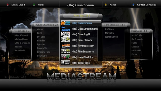

MEDIASTREAM - NEWS:
New menu graphics
New provider arrangement
Provider fully working 100% with vk video (if providers did not remove them)
Nowvideo working only on terrafilms while other providers are applying modification wich results in use difficulty and therefore will not be active (applicable only to those providers that use nowvideo)
Added new download system, thanks to jobmanager plugin
Added zoom while in vision , arrow right or left to enable the function. Please use with low resolution movie
Fixed lots of bugs which were causing crash
Note:
This plugin is a collection of numerous providers and its good functionality is due to the changes they apply, if still available. It's very likely that link or other settings will change, therefore this is the main cause of plugin malfunction.
Next release:
Upload updates
Possibility to de-select not working providers directly from remote control
Fix of bugs and users suggestions
Thanks to authors m43c0 and mmark
Download Beta OE2.0
Download Beta OE1.6

Para instalarlo en la OpenSPA se necesita hacer lo siguiente:
Subir el .ipk a /tmp
Escribir por telnet:
opkg --force-overwrite install /tmp/nombredelpaquete.ipk
opkg install python-html (paquete necesario si no está instalado)
La necesidad de tener que forzar la instalación es porque en el .ipk viene el python-gdata y si lo instalamos normal nos dirá que esos archivos no se pueden instalar porque ya están instalados por otro paquete.
Dejo captura rulando en mi deco con OpenSPA 2.04
    261,5 KB · Visitas: 50
