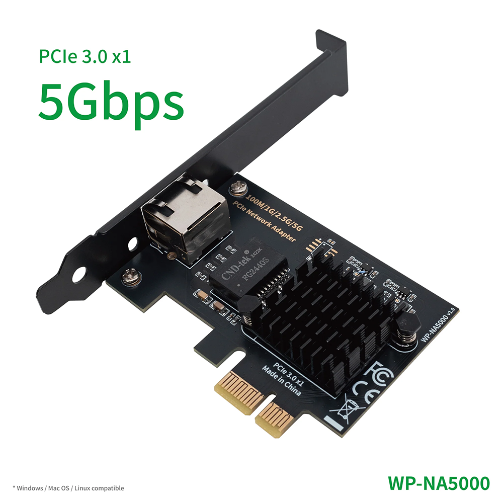

Nuevo arranque RR 24.10.0
1- Fixed support for USB 5.0g network card r8157. Test hardware: wisdpi USB 3.2 to 5GbE adapter
2- Fixed support for PCI 5.0g network card r8126. Test hardware: wisdpi PCIe 3.0 x1 to 5GbE adapter
3- Fix thunderbolt driver ignoring DROM read. #24763413
4- Others.
Gracias a : https://github.com/RROrg/rr
P.D. Ficheros y video manual en la descarga
Descarga Versión RR 24.10.0
